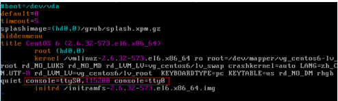

The following procedure uses the CentOS 6 series as an example to modify the
Execute the following command to view the files in the
Execute the following command to open the
Enter
At the end of the line where the
Press
Restart the VM.
