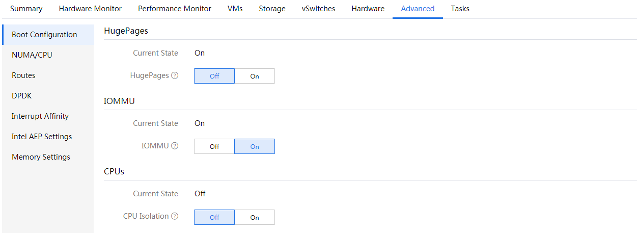

  1. Click the Advanced Settings tab, and then click Boot Configuration.
  1. Enable IOMMU, and then click Save.

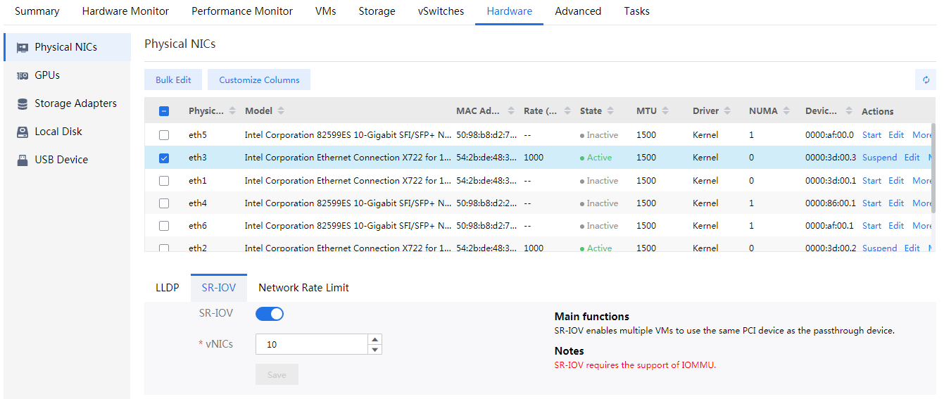

  1. After the host restarts, click Exit Maintenance Mode.
  1. Click the Hardware Monitor tab, select physical interfaces, enable SR-IOV, set the number of virtual NICs, and click Save.
