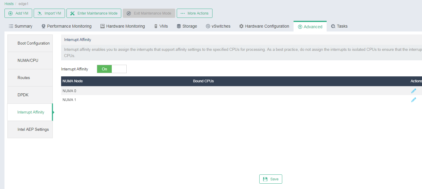

  1. On the top navigation bar, click Hosts.
  1. Select the target host, and then click the Advanced tab.
  1. Click the Interrupt Affinity tab.
Figure-1 Configuring interrupt affinity settings
  1. Enable interrupt affinity.

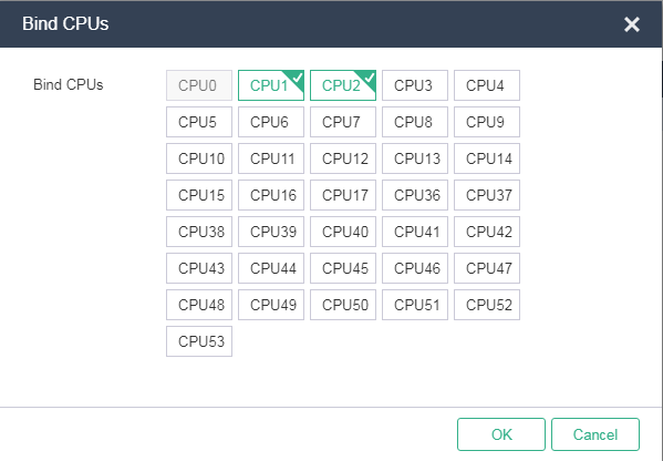

  1. Click the Edit icon  for a NUMA node, select CPUs different from those you have selected in step 5 of "Configure boot settings," and then click OK.
  1. Configure the other NUMA node in the same way.

  1. Click Save.
  1. Restart the host to have the configuration take effect:
  1. Click Enter Maintenance Mode, and then click OK in the dialog box that opens.
  1. Click More Actions, select Restart Host, and then click OK in the dialog box that opens.
  1. After the host restarts, click Exit Maintenance Mode, and then click OK in the dialog box that opens.
